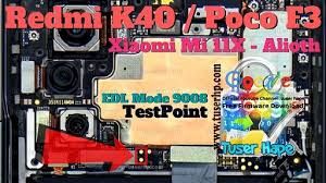

I fiddled with my Mi 11X flashing custom rom flash without paying attention, I clicked on clean all & lock and the bootloader locked and hung
Fiddled with for 3 days and found a way, you have to take the device apart to test the EDL point to do it
1. Enter EDL

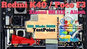

Take the back off and use tweezers or 2 ends of the copper wire to touch the 2 dots as shown in the picture to enter EDL
